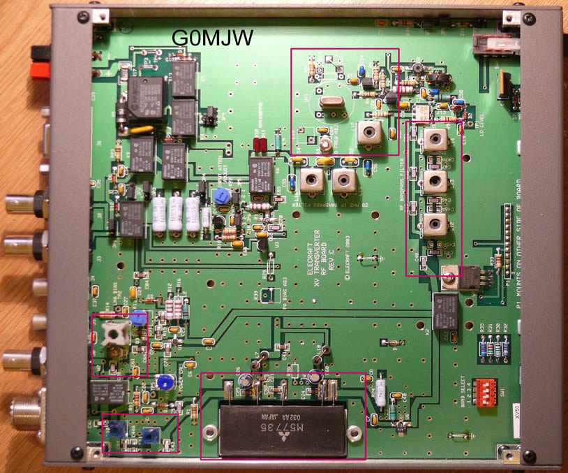

While this may seem like a lot, it is not really all that much in practice, the areas where work is needed are shown in the figure. The most difficult is likely to be step 7. The remainder of this page explains what needs to be done. There is a procedure at the end if you wish to go ahead.

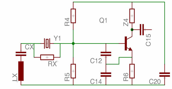

Lets start off with the crystal oscillator. The original XV50 uses a 22 MHz fundamental mode Colpitts oscillator. The simplest modification is to replace this with a 42 MHz crystal oscillator based on a 42MHz 3rd overtone series resonant crystal.
Here is an idea for the circuit:
The component numbers do not all relate to the XV50 parts because this is a different circuit. Rx and CX and LX are added. CX is simply DC blocking.
Here are the values:
Rx 560R, C12 56pF, C14 47pF, LX 7T on 1/4" close wound but ideally a trimmer if you want the lo to be exactly 42MHz, CX 100pF (Re use C12) . LX can be fitted in the vacant place of L19.
R4, R5, R6, Z4, C20, C15, Q1 and C33 are unchanged. Note that this is not the only option. If you are starting from an unpopulated PCB you can avoid cutting the track by using a circuit similar to that used in the XV144 with L4.

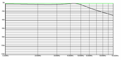

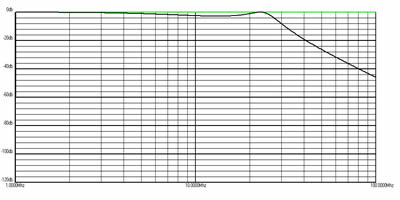

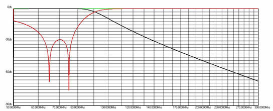

Following the crystal oscillator is a low pass Chebyshev filter made up from C58, C59 and L3. To operate at 42MHz, C58 and C59 need to be changed to 200pF and L3 to 120nH.
The figures show the predicted loss characteristics of the original and modified filter.

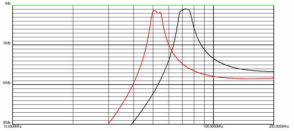

A more complex filter follows the mixer. This is a band pass design. Each component needs to be changed and that includes the coils which would be a lot of work.
Tuning the coils to minimum and just changing the capacitors is possible though less satisfactory in terms of the high frequency cut off, however, it is much easier and not so very bad as the plots show. The real problem is likely to be the image at 98 MHz (2x28 + 42) where this filter is only 35 dB down. Compare this with the original design where the worst image was at 72 MHz (28 + 2x 22) where the filter was down by 45 dB. The difference is not great, however, generally there is nothing at 72 MHz whereas 98MHz is in the broadcast band. In the plots below, note that this is with unoptimised inductors, the tweaking of the inductors will get rid of most of the ripple in the 50MHz response.
The new calculated values are: C48 and C51, 6.8 pF, C45 and C47 10pF, C46 15pF. The rest are unchanged but the coils are tuned close to minimum inductance. The scope for tweaking at 70MHz is limited because of the coils. It is best to start off with less shunt capacitance in each place and then add capacitance in parallel in the C45a, C46a and C47a positions if the coils can not peak the 70MHz band.

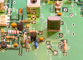

Crystal oscillator conversion
Unsolder the 22MHz crystal. This will not be reused. Remove C12, C14, C69 and C64. This is tricky but using a wire off cut to allow you to heat both pins at once helps. C14 and C69 are especially difficult as one side is grounded and heat sunk by the ground plane. The easiest thing to do it to cut it in half and take out each pin from the top individually. Capacitors are cheap. Replacing the new capacitors is not trivial as you will find it almost impossible to clear the holes of solder. Clear away as much solder as possible, cut the new capacitor leads to 5mm and insert the capacitor from the top of the pcb using solder and the iron on both pins at once. A gently push will get it through. Then move to the rear of the PCB, heat the leads again to melt the solder, push the capacitor fully home from the top side and tidy up the joints.

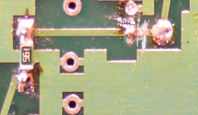

Carefully cut the track between C69a and C64. Then install a 100pF capacitor across the gap using the holes vacated by C64 and C69.

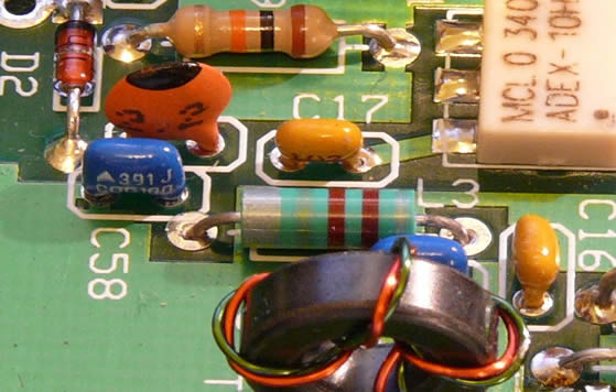

Install the new 42MHz crystal and fit a 560 ohm resistor in parallel on the underside of the PCB. Remove C58, C59 and L3 and replace with the new values. To make 200pF the simplest method is to use a 180pF capacitor in the holes and fit an 18pF capacitor in parallel under the PCB. L3 can be a purchased component, or you can wind it using the standard formula. I used 7 turns of SWG26 close spaced on a 1/8th inch former.
At this point, you could test the LO, however, you should make sure you only do this with the rest of the transverter disabled to reduce the chance of shorting things out - I.E pay attention to J9 pins 5&6 shorted and the power switch off. If you find you can not get the frequency exactly right, you may have to experiment with the value of LX. Remember, it you are using a K2 or K3 getting the frequency stable is more important than getting it exact as offsets can be corrected at the IF. The voltage measured at the LO test point should be around 0.8 to 1.2V.
New Resistor and cut track. Extra capacitor added as crystal was not getting onto frequency. I had not defluxed it at this stage, I have now.

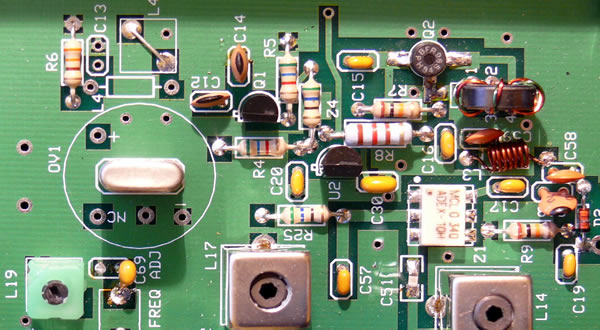

This shows the LO from the top. Notice the new coil in place of L19, the unusual location of the capacitor by C69 and the new home made L3.

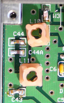

It is very important to modify the low pass filter as 70MHz is already significantly attenuated with the stock filter. L10 and L11 are now both 100nH as I had some 100nH coils available and this simulates reasonably well. The new values for C42 and C43 are 60pF and for C44, 120pF Remember that this part of the circuit operates at significant power - use appropriately rated low loss capacitors here. My replacement LPF is not too pretty as the coils were not an exact fit and the capacitors in series look odd. However, this filter produced a measured loss of under 0.2 dB at 70MHZ and had the predicted rejection of 30 dB at 140MHz and 60 dB at 210MHz.
The replacement LPF.

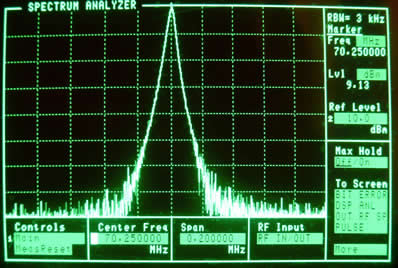

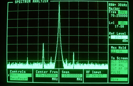

Close in and wider plots at just under 10mW output

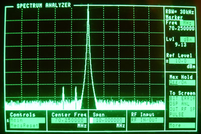

A plot at 50mW - Spurii starting to be a problem

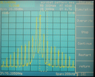

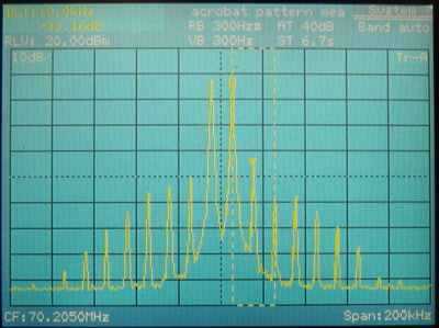

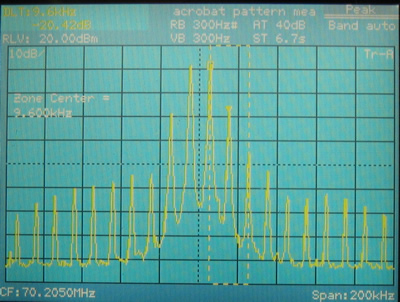

Here are some photos of the spectrum analyzer screen at 900mA module bias - Sorry about the quality, I didn't have it connected to the network to download them electronically. The response is not perfectly symmetrical though both tones are at the same level.
10W Output
20W Output
30W Output
